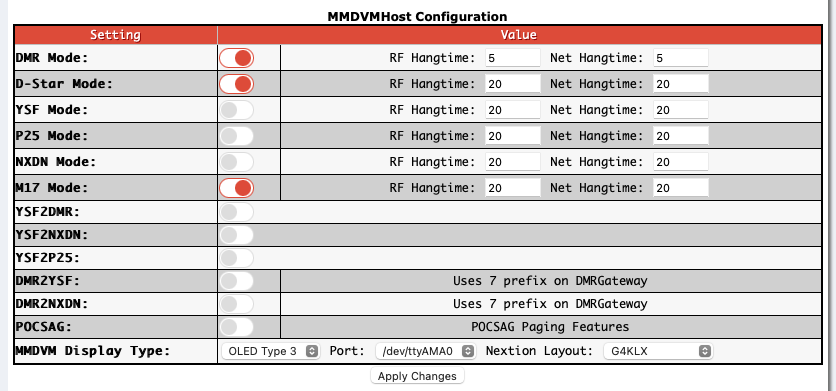

Now that we have a supported firmware it is time to enable the M17 mode from the configuration dashboard.
Enabling it will generate a configuration file in /etc/m17gateway; it is possible to edit it with the full editor available under the expert configuration page.
If you only care about the startup reflector, it is possible to change it from the regular configuration page.

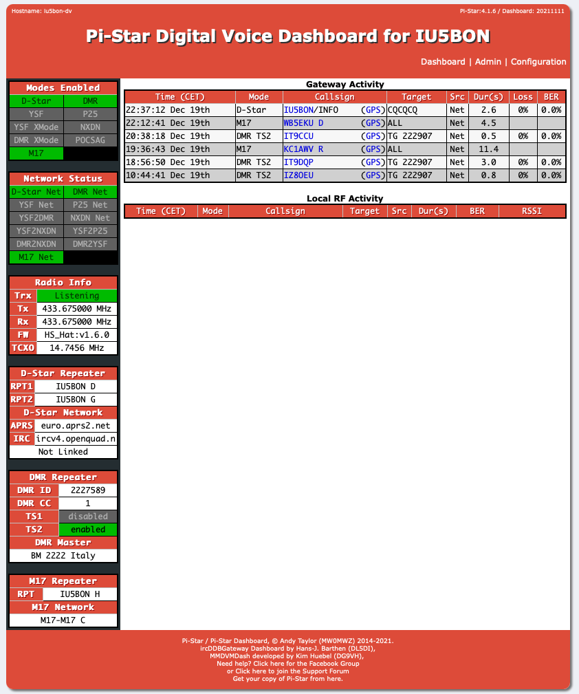

This is how the dashboard looks like when you have M17 enabled.

If you connect DroidStar and Pi-Star to the same reflector it will be possible to see the transmissions on the dashboard (and on the hotspot display).
