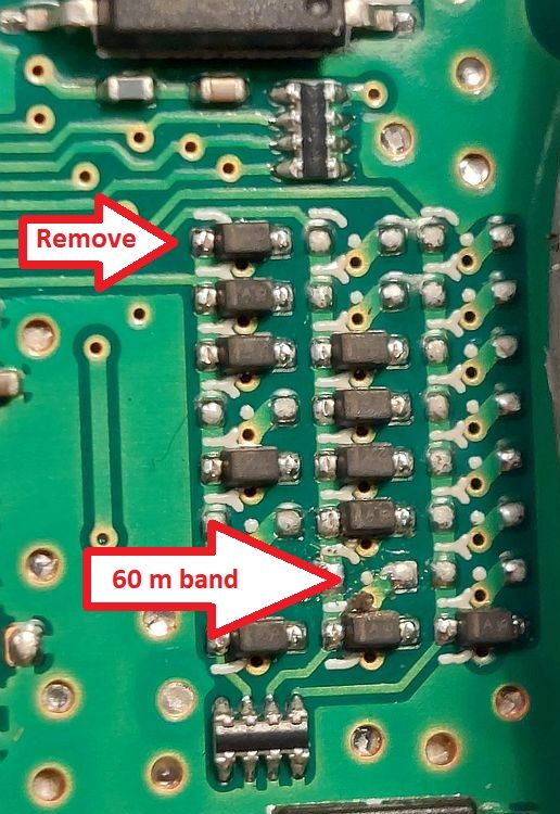

The trick is to remove a diode inside the radio.

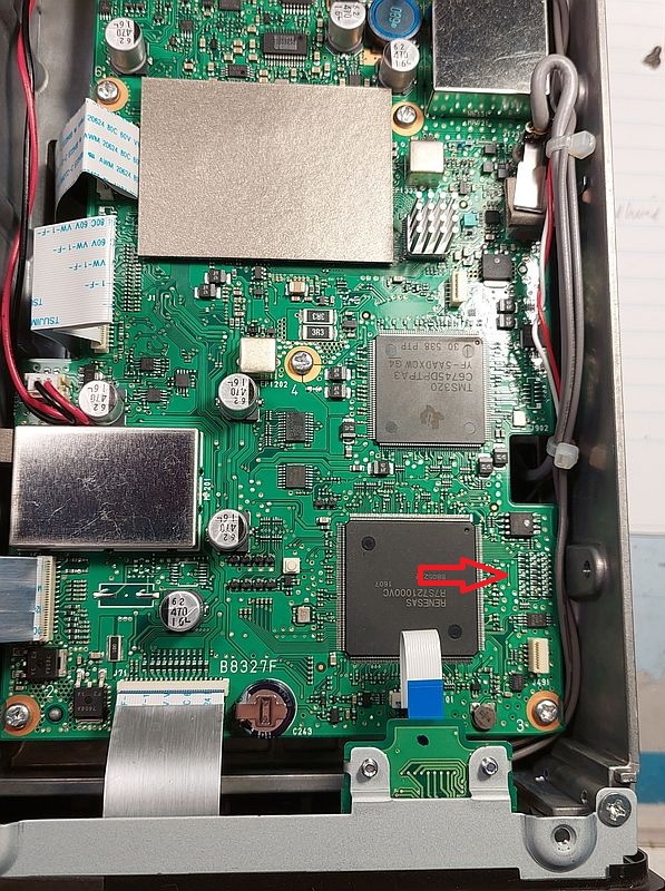

Here I have removed the bottom part of the radio
I closer look at the diode matrix, Notice, The diode for opening the 60 m band was already removed.

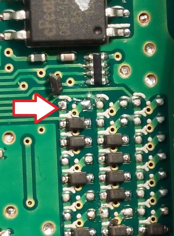

Now it is done:

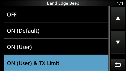

At first sight the operation did not work, but I had to make change to the band edge because I used this setting in the Band Edge Beep:

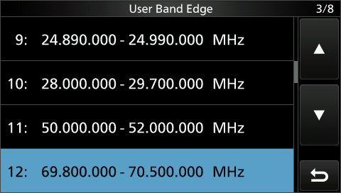

In the User Band Edge setting I now could edt the band edges for the 70 MHz band:
So my radio is not able to TX everywhere but only where these settings permit, and I think this is the way to do this.
