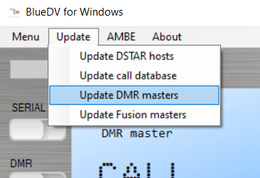

    2.) Before we begin the configuration make sure you have the latest DMR Masters database loaded by clicking on the Update Menu item and then Update DMR Masters link as shown below.

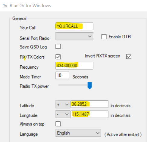

    4.) In the General Section enter your Call Sign, Verify the frequency is a valid frequency in the UHF Amateur Radio Band and make sure there are valid Lat and Long Values, Default values should work just find but make sure there are values here.

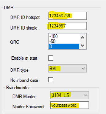

    5.) In the DMR Section enter the following:
    • DMR ID Simple - This is your 7-digit Radio ID
    • DMR ID hotspot - This is your 7-digit Radio ID plus two digits to denote the alias ID. If this is your first hotspot then use 01 or if your second use 02, etc. This must be a 9 digit ID (7-digit Radio ID plus Alias two digit)
    • DMR Type - Select BM for BrandMeister
    • DMR Master - Select your preferred DMR Master to Connect to.
    • Master Password - This is your hotspot security password set in self care dashboard. If you need to create one for forgot what it is see HotSpot Security guide to create/reset the password.

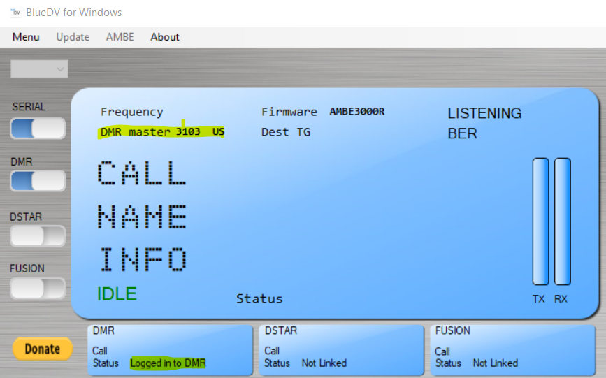

    8.) To start the connection click on the Serial Radio Button, wait for it to establish connection to your device and then click on the DMR Radio Button. If all configurations where entered properly you will see under the DMR Status area, Logged into DMR. Plus you will see on the main screen the server it is connected to as shown below. This is an example of a successful connection to BrandMeister.
